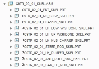

I am writing to ask you how to handle the following situation:
We created the suspension assembly of the car using the structure of the moving skeletons (there is a first skeleton, which Creo calls "Design Skel" which contains all the references and then a series of other skeletons, which Creo calls "Body Skel" , which represent all bodies with their kinematic constraints).
(see image 1)
The suspension components are then rigidly mounted on the relative skeleton (e.g. the hub carrier assembly was assembled with the skeleton references C9TR_02_01_LH_HUB_CARRIER_SKEL.PRT).

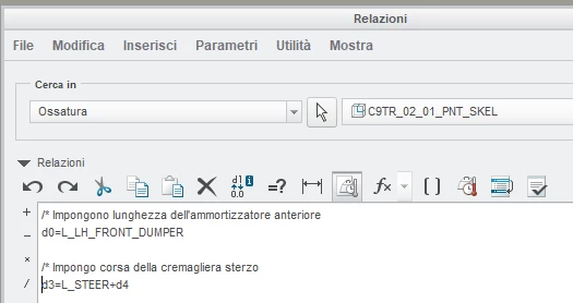

To govern the movement of the assembly we use the stroke of the shock absorber, defined as a parameter (for the front suspension we also have the translation of the steering rack).
(see image 2)
The parameters are used to modify the length of the shock absorber and thus to realize the movement of the assembly.
