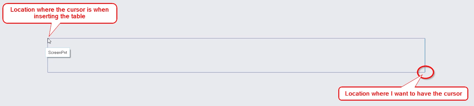

I’m working in Creo 12 and I do have some tables and BOM tables, and I'd like to change their anchor point. By that, I mean the position of the mouse cursor when I place them using "Table from File". I like to have it in the complete right bottom.

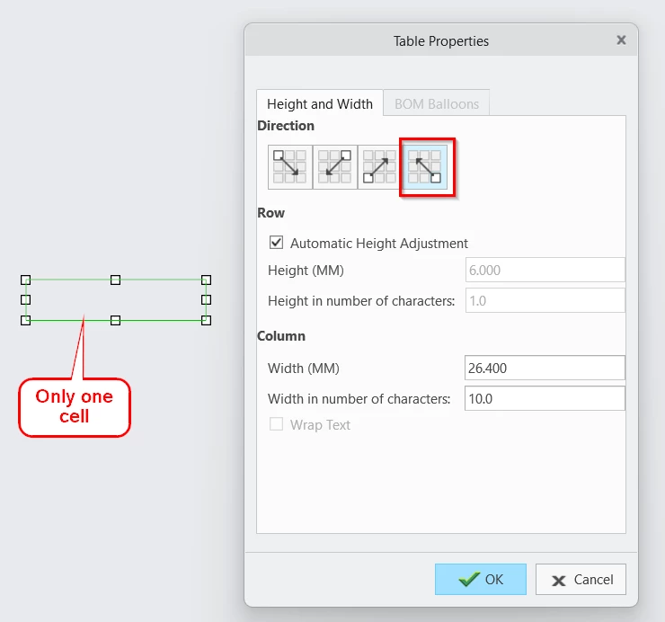

What I also have tried to do, is:
  • first create a table with only one cell
  • change the growth direction to the right bottom corner
    A table with only one cell and the direction from the right bottom corner

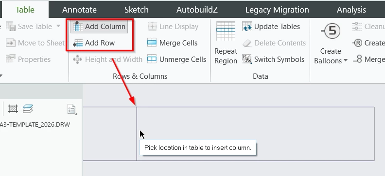

  • add some columns on the left and a row on the top
    Adding columns on the left of the first cell
  • save the table
  • when I add the table via “Table from file”, the corsor is at the top left corner of the first cell:
    Location where the cursor is when adding this table (started with only one cell)
So this wasn’t the solution either.

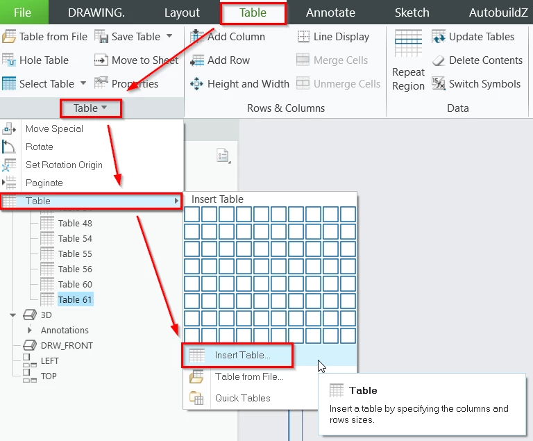

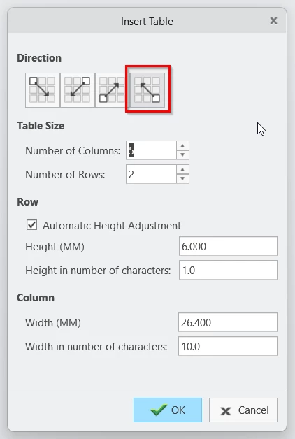

I think setting Table Growth direction prior creating a new table will help.
Try the steps as:
Table Tab > Table Pull down > Insert Table > Set Table Growth direction to leftward > OK and save the table.
I hope this will help.
7-Bedrock
Jul 30, 2026 3:02 PM UTC
Hi ​@Mahesh_Sharma
I think that's actually the solution!
Sometimes it's that simple!
