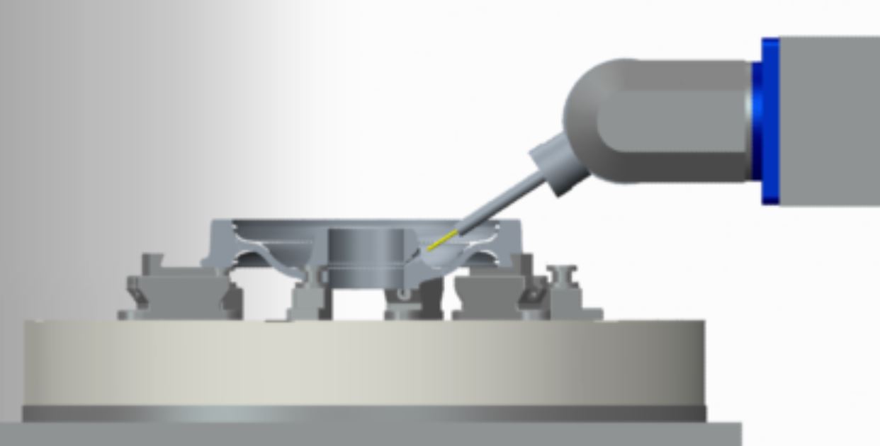

I have been working on a project over the last couple of weeks preparing model and drawings for a Capex proposal for new plant.
now I have been doing some animation of the equipement in action. but when I output the files to a movie it come out bad
I even tried to output with photo render, and it either crashed Creo running out of memeory, or comes out looking like the image below.
it looks fuzzy and out of focus.
Can anyone help with pointers and tutorials on rendering and animations.
THank you

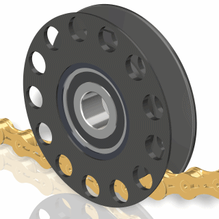

I think PhotoRender is crippled to help sell PhotoLux. I don't use it.
You need the larger frame and I like using shaded with reflections; turning the options for higher quality graphics; removng the shade on the floor (just maintain reflections where applicable) and avoid perspective due to the poor control over saved perspective views. I am also careful with feature appearance changes since it removes the ability to use the animation transarency feature. One overall color must be assigned to have the transparency work in animations.
Even for mechaism animations only, I try to use these guidelines.
You should be able to get this level of quality without too much issue:
Note the wavyness of the shadows....

Thank you for the advice
your suggestions made an improvement , and I think I can use the output now.
I expected that the basic package should render an animation better than what it is doing now.
