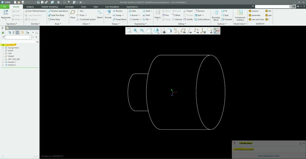

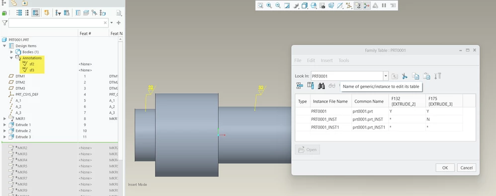

I make model which have 2 machining operations in single model. I want to make individual drawing for both operation with machining symbol so I used family table and make two separate part for both operation.
When I created drawing of both part and place machining symbol on machining surface. When I place machining symbol place on second machining operation face (in instance part drawing), obesely which surface not show in my generic model. So when I opened my generic model meanwhile second operation machining symbol failed in generic model. I attached images for reference. Please help me how to solve this problem.

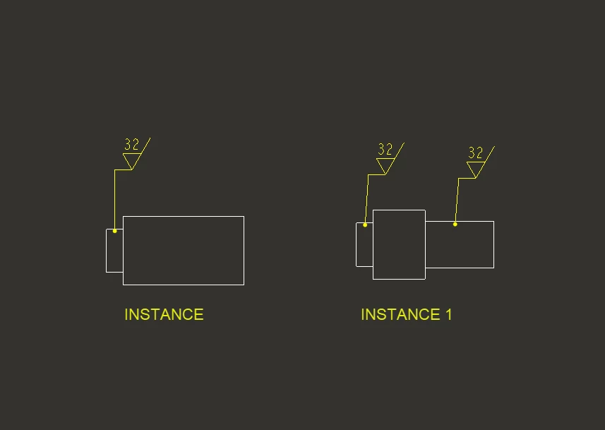

I just built this test model and dwg in Creo 9. The drawing views display as required when placed in a drawing using each instance of the part. Note the generic model is not placed in the drawing in this example.
