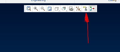

Hi Doug, i too have experienced strange layer behavior. With regards your problem, can't you just turn them off with the 'Annotation Display' icon?
Regards
John
March 6, 2015
I can, but using layers gives more control over what I see and what I don't.  That icon is all or nothing.
