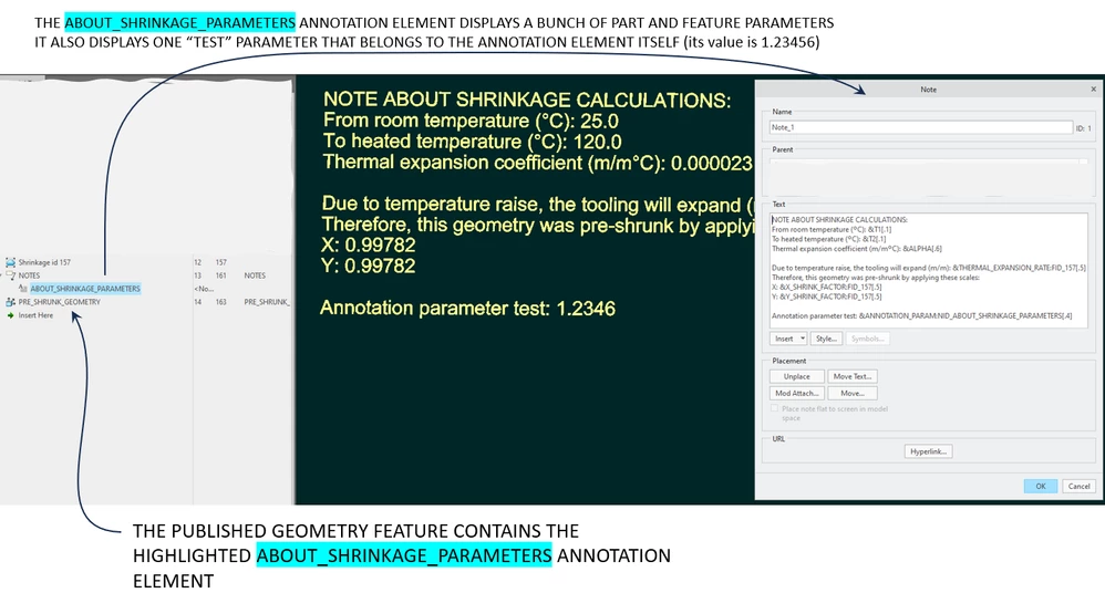

How the annotation and published geometry was prepared in the source modelHow the annotation and published geometry was prepared in the source model

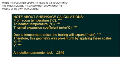

What the published geometry looks like in the target modelWhat the published geometry looks like in the target model
I realize that to get around this *** issue, I can craft my note to only use its own "annotation element" parameters.  And via relations, those can be made to be equal to the "original" feature and model parameters.  But that seems like twice the work...
