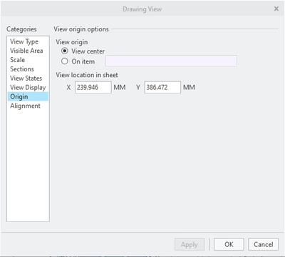

Open the View Properties, click the Origin tab.
Is it set to View Center or on an item? Maybe if origin is always set to an item, your notes won't move.

Thanks Aputman. That sounded like the right thing but tried it and no change.  All the labels are tied to the spline, not even the "reference point or geometry" but the spline.
