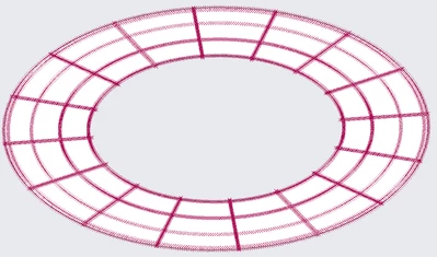

This problem involves reconstructing an annular surface using datum points-->curves and the boundary blend surface feature.  I have created a set of circumferential curves and radial curves to be used as the two directions.
The circumferential datum curves have the ends condition set to either tangent or curvature using a smaller curve segment created from the same point set.  I do not know of any other way to generate a closed continuous/smooth curve from points than this.  When I create the boundary blend surface, the result is a quilt with a small sliver surface in the region where the ends of my datum curves exist.  How can I eliminate/avoid this sliver surface and instead generate a single continuous/smooth surface?

Thanks for the response.  I apologize for not mentioning that each radial or circumferential datum curve is constructed from datum point sets that originated from a CMM part inspection.  So, yes, each individual curve is unique, and no, the points do not lie in a plane.  The actual topology is quite complex at the micron level and that's what I want to capture and analyze.  I thought radial and circumferential scans would be the preferred way to do this.  I have another totally different method which uses an optical scan and and stl surface, and ultimately want to do a comparison with that and whatever surface reconstruction approach I can come up with for the CMM scans.  If you have some suggestions to try, I would be happy to take those and report back.  My less-than-ideal workaround involves creating half-annular boundary blends by trimming the circumferential curves in half.  But there are a lot more features required to get to that end result and a single surface seems to be ideal if it can be generated.

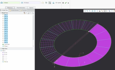

I have to admit I have never used the style feature before, so I have very limited knowledge of all the ins and outs but here is some feedback from my first attempt at using it.  My only knowledge base so far is from reading documentation, your remarks, and information I've found on the internet.  Also, it is worth mentioning that I am working with Creo 4.0, but have access to 6.0 as well if there are newer features that could help this situation.
The requirements for a Style surface appear to be significantly different than Boundary Blend.  Because of this, I am limited in how much of my point-->curve data I can use. The following is the best I have come up with so far.  It uses the outermost and innermost circumferential "curve from datum" curves as the primary chain references.  It does not let me select cross curves unless the primary chains are "curve from datum" curves (I can't directly select the original datum curve features outside of my Style feature).
The 16 radial datum curves can be selected as the cross curve chains.  For these, I was allowed to select the datum curve features outside the style feature rather than create and use curve from datum features in Style.

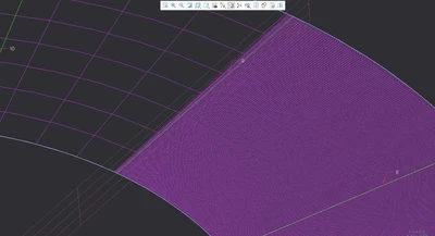

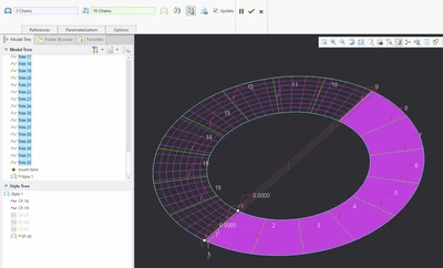

The style feature doesn't like including the interior circumferential curves as either primary or cross curves.  Not sure why this is a limitation, but I can include them in a boundary blend.  Also, I don't know what to make of the surface topology preview in purple.  Half of it looks to have a much finer mesh than the other half.
There's also a suspicious looking portion of the resultant surface that has a small sliver portion.  Not sure why this is happening.
I would be willing to construct some sort of a composite style surface/quilt, but am not sure on how to maintain tangency/curvature with adjacent segments.
