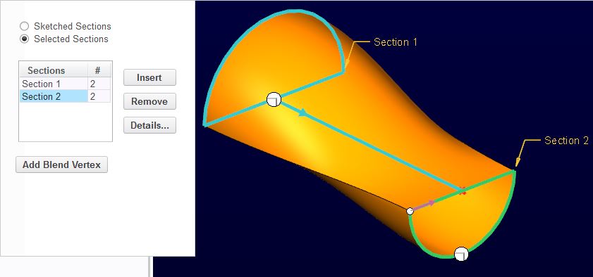

Anyone else have any issues with swept blends?
  • May 9, 2013
  • 1545 views
We had an issue where we tried to do a simple swept blend with 2 sections, each comprised of an arc, and a straight segment, though on each section the arc was on the opposite side. I other words, from one section to the next, either an arc segment would transition to a straight segment, or a straight segment would transition to an arc. When we tried to do it as a solid cut, inverted the sections so that it transitioned the arc to arc, and line to line, giving us a preview as if we'd had the start points reversed. We had to do it as a surface, then do a "solidify-cut" to make it work. Weird.
Anyone else see anomalies like this?
May 9, 2013
You lost me at "simple"! You want the line to become an arc and the arc to become a line?
May 9, 2013
Patriot_1776
May 9, 2013
Yep, except these were open sections, where the line was tangent to the arc, it's just that as you swept along the trajectory curve, they switched. Also, the trajectories were curved. We got some REALLY weird results.
