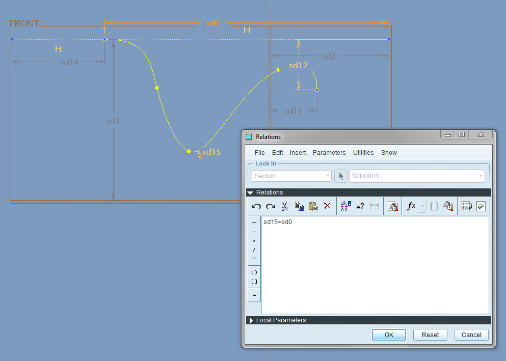

Well I don't have the actual one to hand, but the idea is to bend a flexible PCB through a slalom of gaps and guides in order to check the fit with the part geometry. I have the PCB imported from IDF and would like to be able to tweak my spinal bend without invalidating the feature (by changing the length of the part).
I have actually managed to sort it by drawing the spline more-or-less spot on, and then just editing the one point which Pro/E allows, but I think this is still an interesting modelling topic.
My sketch looks something like this:

So, you mean in sketcher itself? Looks like you got it. Still not sure exactly what you want.
