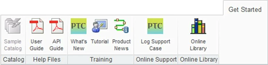

If you already have a license of RSDlite, I recommend you upgrade your license pack so that you can download Creo Schematics 1.0.
When you start Creo Schematics select the get started tab and click on Tutorial. The tutorial will teach you how to create wiring diagrams, create catalog symbols and setup the working environment.

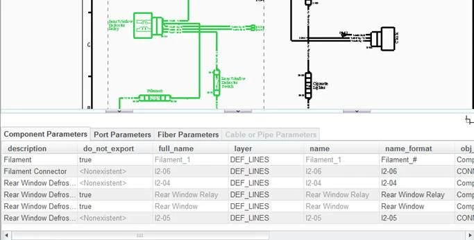

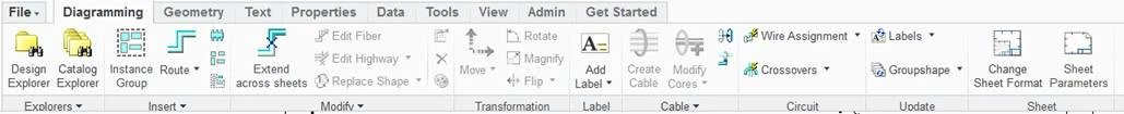

PTC have invested heavily in improving the usability of schematic design and with Creo Schematics the learning curve should reduced when compared to previous release of Routed Systems Designer. If you decide to get started with Routed Systems Designer you will not benefit from
· Enhanced Usability
o Ribbon UI
o Pre-Selection highlighting
o Drag handles
o Sheet tabs
o Embedded parameters
· Improved Interoperability
o Import PCB signal information
o Import ad-hoc port information from csv
o Drive Wildfire 3.0 - 5.0 and Creo 1 cabling and piping design
