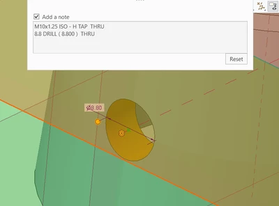

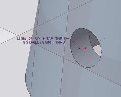

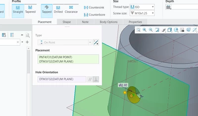

I have created this tapped hole however I cannot see the threads.
Creo parametric 9.0 Student version

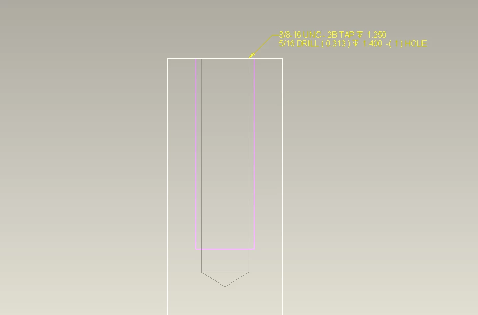

The threads are represented by a surface quilt. The thread geometry is not created when using the standard tapped hole features.
Display your model with hidden lines and you should see the thread quilt as seen below (purple).

Thank you for the clarification.
