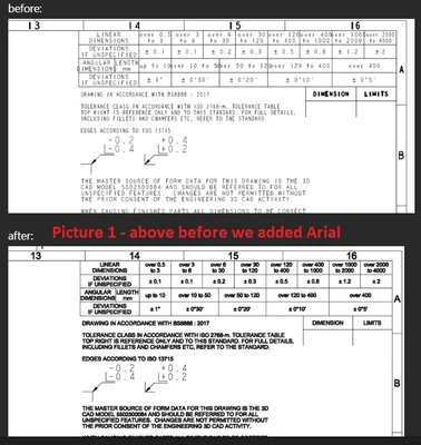

Arial on pdfs from worker looks bold when zoomed out.
Dear all,
we have bumped into strange issue, or possibly we're doing something wrong.
We have a Windchill product in which we use client's configs including fonts, in their case Arial.
Suddenly some drawings started using different font which caused text overspilling its respective table cells.
Anyway, during investigation we learned that for some reason we were missing Arial in the default Creo folder on worker machine (../common/text/fonts) and in the config.pro there was no other folder specified (pro_config_dir commented out).
We copied over the Arial font to the folder, and drawings started using the font all right, BUT it's displayed in a very strange way.
Attaching an image to illustrate it (picture 1) - the "futher" you are the more the font looks as if it's bold.
And it even prtins out this way on a paper.

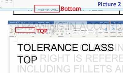

But when I zoomed in typed fragment of text in Word and overlayed one with another (picture 2), it looks all right.
Arial bold should be proportionally different from plain Arial, but these are identical.
How come the more we zoom away the more bold it looks? Is there some settings in the config.pro / *.dtl file that affects this?

I guess that Stroke All Fonts option is set during printing. In this case Creo applies pen width (set in pentable file) to every character outline. Because of this text is displayed as bold.

Anyway it seems you were right. When I open a drawing in Creo and in the PDF Export Settings I select "Stroke All fonts" instead of "Use TrueType Fonts" the resulting drawing really suffers from the same "bold" problem, while with "Use TrueType Fonts" selected it doesn't.
The problem is I am not sure how to make worker (Creo 6) to do it the same way.
If I understand correctly this should be driven by intf2d_out_pdf_stroke_text_font "feature" in the config.pro file.
I tried to set it to none as well as non_ttf on the worker (it was set to ALL originally) but no change.
What am I doing wrong, please?
Also have to mention (to make it even more complicated) that a product which suffers from this is in Creo 4 where the feature was different (I believe intf2d_out_stroke_text) and we use client config.pro while the worker use our own config.pro, but I checked them both and in the client one there is no this feature set and on the worker it's set to all (but as mentioned I tried to both other values with no effect).

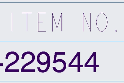

Your top picture is using 'line fonts' and your bottom picture is using 'TrueType fonts'.  Line fonts in Creo look the same no matter how far you're zoomed in or out.  Essentially the line is a certain number of pixels wide and it stays that width regardless of zoom.  On the other hand, TrueType fonts have a pre-defined width to them and scale as you zoom in and out.  Because of their thickness, TrueType fonts will always look 'bold' compared to the line fonts.  I agree that there is less distinction between normal and bold TrueType fonts in Creo.  The users will eventually get used to the thicker TrueType fonts after a while.  It helps to switch everything in Creo to using TrueType fonts and avoid having a mix.
Notice how the width of the line font does not change with zoom:

  • Stroke none will convert all line fonts to Creo's built-in TrueType font, and also output any TrueType fonts that exist.
  • Stroke all will draw all fonts as lines and dots.  No TrueType fonts will listed in the output.
  • Stroke non-ttf will draw all line fonts and lines and dots, but still output any TrueType fonts that exist natively.
None of these options will change TrueType fonts back to line fonts.  Any TrueType fonts present in the drawing are going to be exported 'thick', the only question is 'how' - either with the native TrueType font embedded in the file or redrawn as lines and dots.
