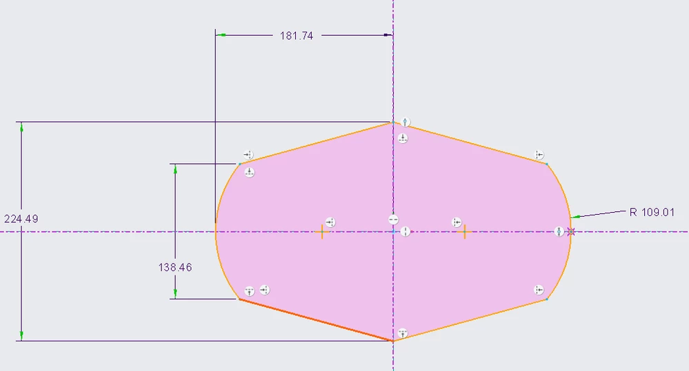

Arrow color - sketching
Is there a scheme to the arrow colors while sketching?
I am making a simple extrude and noticed that 6 arrows are red and 1 is yellow.
Is there any significance to this?

This is an improvement from creo8, the color arrow means that you can drag from it, and not color arrow mean you can not drag from it.
You can see this improvement in this video https://www.youtube.com/watch?v=sxS5nlXGHEA&t=75s  minute 1:12

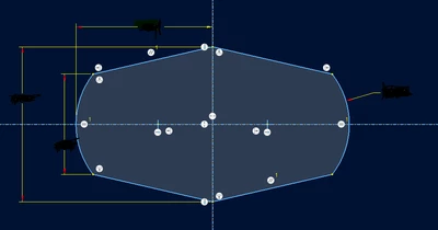

in Creo 9.0.2.0 I can see green + black arrows when using Default Theme.
StephenW
Aug 1, 2023 4:23 PM UTC
Just noticing both sketches matched so I tested it.
Arrows to the geometry are red (green) , arrows to the reference are yellow (black)
I'm on Creo 6 and thats the case also. I don't remember noticing this before.

I hadn't either, hence the question.
