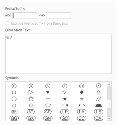

Hi @QNTran682 ,
All the symbols are there, all you need to do is to update the following model detail option (or drawing detail option, depending on which environment you are in):
Detail option name: symbol_font
Value: asme or stroked_asme
(you can access the detail options page via File-->Prepare-->Model Properties-->Detail options)
Once you will apply the new value for this option, you will see much more text symbols available:

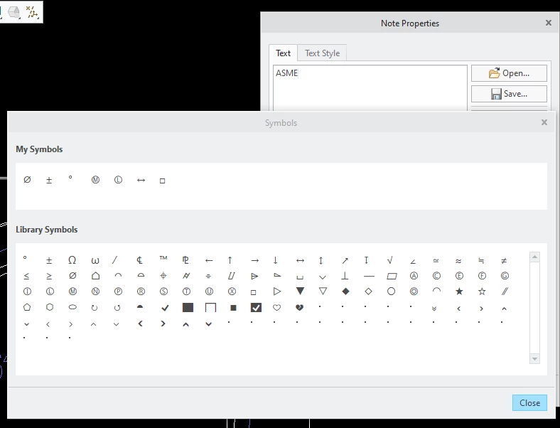

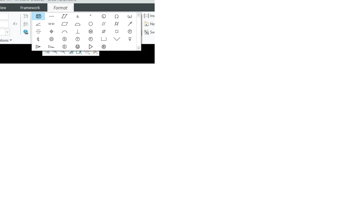

I found the symbols to insert. However my text box does not display the Symbol graphic text properly. So I can't see what the symbol is before inserting. How can I make it look like the way your pictorial looks? Here's what mine looks like.
May 17, 2023 1:43 PM UTC
@QNTran682 wrote:
Thank you!
please do simple test:
  • create new empty drawing
  • set symbol_font asme
  • add new note
  • display Library symbols dialog box
