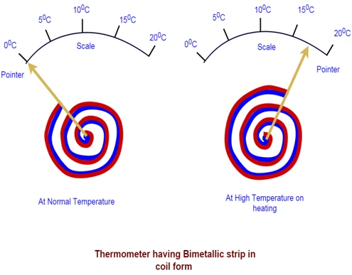

Hi, I have been creating sweeps of a small rectangular sketch attached to a spiral trajectory. I am trying to create a bimetallic coil, like the one in the photo below. I wish to model it in Ansys. However, to do this there needs to be two different materials (i.e. red and blue in the below photo are separate materials, and therefore separate objects).
My problem is that I have created the two spiral sweeps, and I'm having difficulty creating an assembly of the two joined together. They tend to overlap at the very center, and are constantly at 'partially constrained' status.
If anyone could help I would be very very grateful. The only constraints are that the entire assembly must fit into an envelope size of 50mm x 20mm x 15mm, so i left my outer spiral sweep with an outer diameter of 20mm. And that each material must be no less than 0.5mm thick. Thanks!

I would propose you do this using the following technique.
Use curve from equation to create a logarithmic spiral base curve. This curve would represent a curve that lies on the shared surface of the two "coils" as they are wound together as shown in your pictures. You can use this base curve to create both the red and blue coils as sweeps and then assemble each of them to a single assembly using the default constraint. Sweep one to one side of this base curve and the second coil to the opposite side, they will then line up when assembled.
You will need 3 files to do this red coil part, blue coil part, and an assembly containing both. Hint, once you create the first coil perform a save as to rename it and then flip the z direction in the sweep to create the second coil quickly.
In a cylindrical frame of reference the parametric curve for a log spiral is: r=A*exp(B*t)
where r is the radius and A & B are scalar quantities.
 For example the equation in the  creo curve feature would take this form. Z=0 if the spiral lies within a single plane.
A=d11/2+2.6
B=0.348
z=0
theta=t*360
r=A*exp(B*t)
