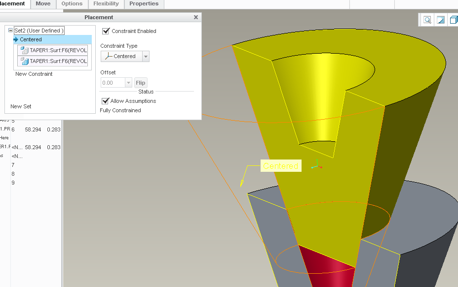

February 14, 2017
If you've never tried the centered constraint, consider trying it for situations like this, tapers or sphericals.
Only one constraint is needed if you don't require rotational control of the part (allow assumptions in the image above).
It's a "nice to have" item, not that there aren't other ways to do it.
