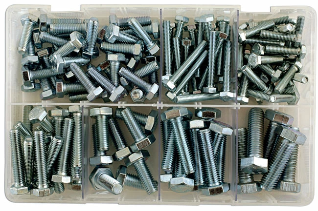

I would like to have an assembly file which contains a box and many of a same part. Like a box full of bolts. Is there way to assemble those parts in not a particular manner but rather in a random way? An example picture is shared.

AFAIK, there is no function that would automate this for you. It is feasible that you could randomly distribute and orient coordinate systems using an external program and then import the csys into Creo from file to accomplish this. If you require geometric fidelity of the parts packing arrangement, then this becomes much more complex to reduce to practice in Creo.
