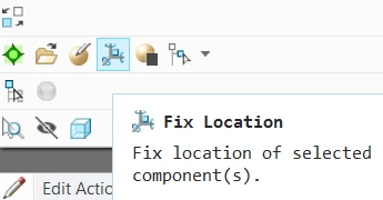

How to make fix constraint to multiple items at a time?

There should be the "Fix Location" command in the right-click menu.  Note it is only available if ALL the selected components are unconstrained.
Aug 16, 2022 8:18 AM UTC
It's already assembled with some other reference. I want to remove that reference and give fix constraint. Is that possible?

Aug 16, 2022 8:30 AM UTC
you cannot fix constraint to multiple items at a time.
