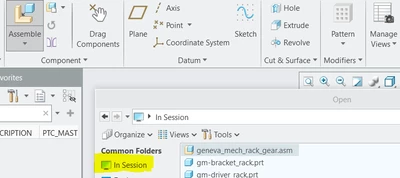

Assembly defaulting to Desktop when assembling a part in creo 8
Whenever I select assemble CREO always defaults to desktop  but I want to always default to in Session  , is there a config option that can be changed to default to parts in session instead of desktop. If NO I would like to default to working directory.
Jan 1, 2025 7:24 PM UTC
add following option into config.pro file "to default to working directory".
file_open_default_folder working_directory
Add following option into config.pro file "to default to in Session".
file_open_default_folder in_session
