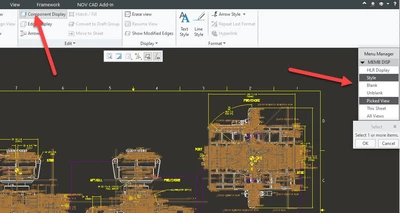

Repeat region BOM tables can't work across family tables or simplified reps.
Another possible way to handle this is to use Component display in the drawing. You can blank or change the hidden line removal or set a part to phantom in the drawing. That way you only have one model in the drawing and your BOM balloons work across views.
It's not ideal for models with 1000s of components but with just a few, it works well.

Yes it works for a few components, but I also need to hide some pipes which are not parts because the way we do it is make the pipes in the pipe tool but dont convert them to parts, we just display them with the Display Thick Pipes button inside the tool. So maybe that is a practice that we will have to change for this to work properly

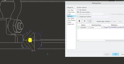

Or my preference, use a local cross section to breakout an area behind a part.
