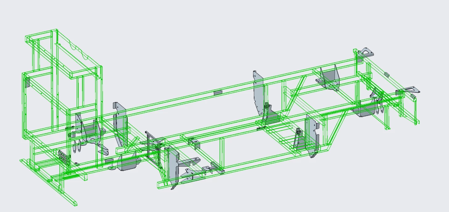

I need to develop assembly drawing of mounting of several brackets on the frame (green lines on the screenshot).
But the frame should not be a component of this assembly. It should only be an external context.
- The mass of the frame should be excluded in the mass property calculate;
- The frame should not be included in assebly BOM;
- The frame should be shown by a thin line in the assembly drawing.
- Frame is a real assembly which I use in another product. And I need the real frame to be associative with the simplified frame-context.
Regards,Max

If you are using Creo 7+ you have the option to import the frame into a part and define the geometry as a construction body in the Creo part. This will exclude the frame from mass properties. Construction bodies are also excluded from repeat regions (BOM table). You will be able to include this body in an assembly and constrain your brackets to it as shown in your picture.
To control the display of the frame lines in a drawing of the frame you may have to resort to pen table assignment when plotting.

For your scenario I would do the following:
Create a skeleton model that will contain the geometry of the frame. This skeleton will reside in an assembly that represents the picture you posted.
Open the skeleton model and import the frame geometry as surfaces, not solid. This will exclude it from mass props but it will be visible.
Add the brackets to the assembly constrained to the frame as needed
Skeleton models do not show up in the BOM unless you specifically include them. They do not contribute to mass or surface properties. They can be displayed in drawing views and can be included during the creation and manipulation of simplified representations and external shrinkwrap features.
Bring the frame in as a skeleton model to your assembly.

It can be tested with any sleteton model + shrinkwrap feature. When I paste it in drawing view I can't shown it it thin lines using ''Component Display".
