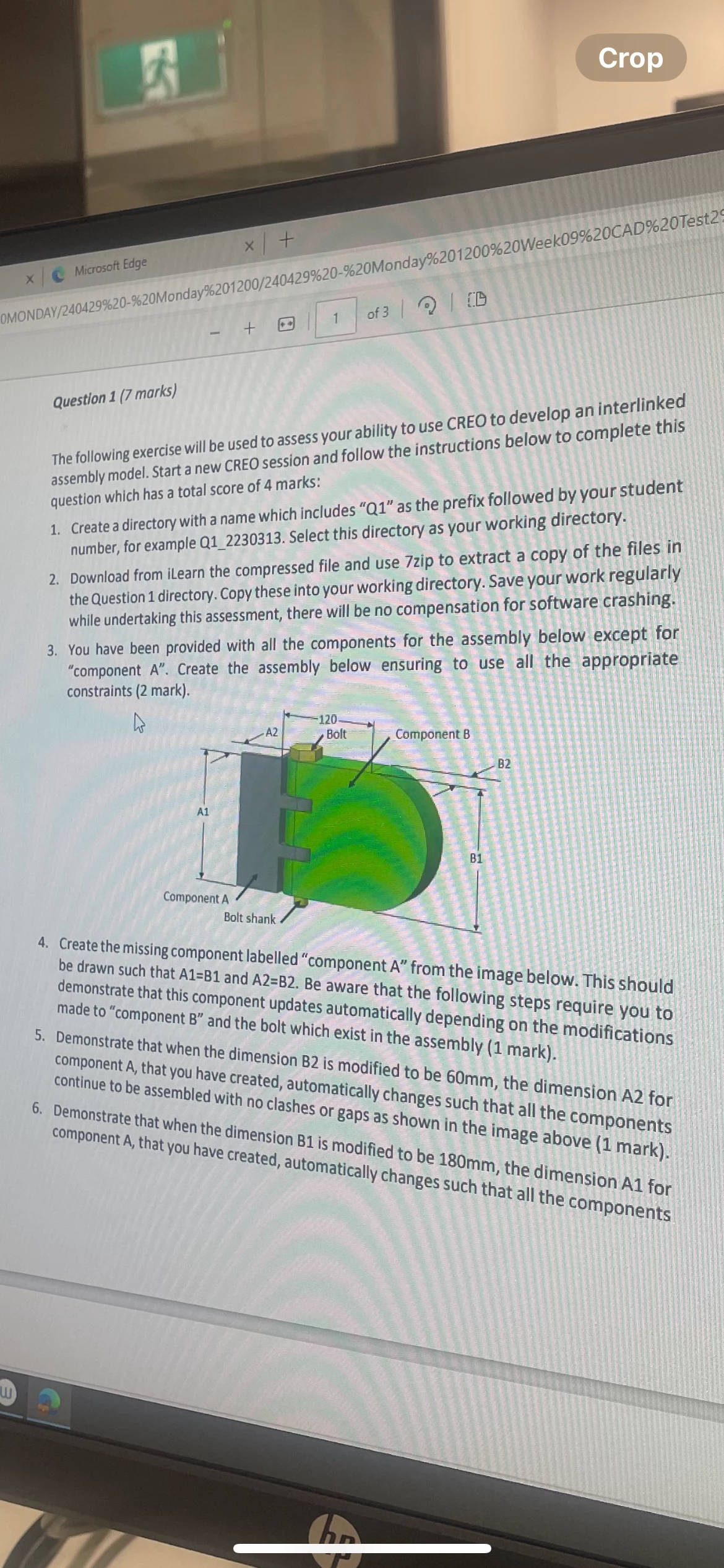

I was looking at getting some guidance with simple assembly within CREO.
I've been tasked to a create an assembly in which I am given 2 complete parts as well as am required to create a third part for this assembly.
When creating the third part of the assembly  is should be drawn that A1 = B1 and A2 = B2, meaning that this component updates automatically depending on the modification made to the first two components which exist in the assembly.
How do I go about this? Do I create a seperate brand new model and then add this to the main assembly. OR should I assemble the first two parts together and then create a new part within this assembly.
This is to made made that no clashes or gaps happen within the main assembly model
