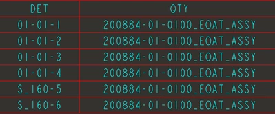

I want to add portion of main assembly name into repeat region for each member:
FIXTURE=extract(asm_name,8,5)
DETAIL=FIXTURE + '-' + itos(rpt_index)
For parts it works as expected: 01-01-1, 01-01-2, etc
The problem is that "asm_name" in repeat region relations returns value for sub-assembly name which exists in main assembly: S_160-5, S_160-6.
If I place "asm.name" under QTY column everything is as expected.
DET column gets values from relation: rpt.rel.DETAIL
What am I doing wrong?

I have found a "workaround", as usual with Cre(p)o.
I made new column and placed asm.name in that column and then I called asm_name in relation for first column. I will "hide" asm column afterwards because its not needed to be seen on this table.
January 26, 2021
Another way to accomplish this would be to add asm_name to the list of local parameters within the repeat region. It's a better way to calculate the value without having to deal with shown/hidden columns. When calculating values for BOM attributes within a repeat region, the relations need access to the thing they're trying to calculate.
  1. Edit the relations of your repeat region
  2. Expand the list of local parameters
  3. Click the plus icon to add a new parameter to the repeat region
