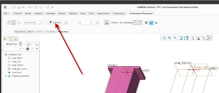

I want to know that is there any command to move part to assembly origin.
As an example,
As you see in attach photo,
part origin and assembly origin is different.
I want to move part origin to assembly origin.

rrana-21-VisitorAuthor

Ahh, that in assembly...for the first component, you can use the "default" constraint
Where it says automatic, change that to default. That will make your coordinate systems coincident.
Then look through tutorials for assembly to learn all the other options.
