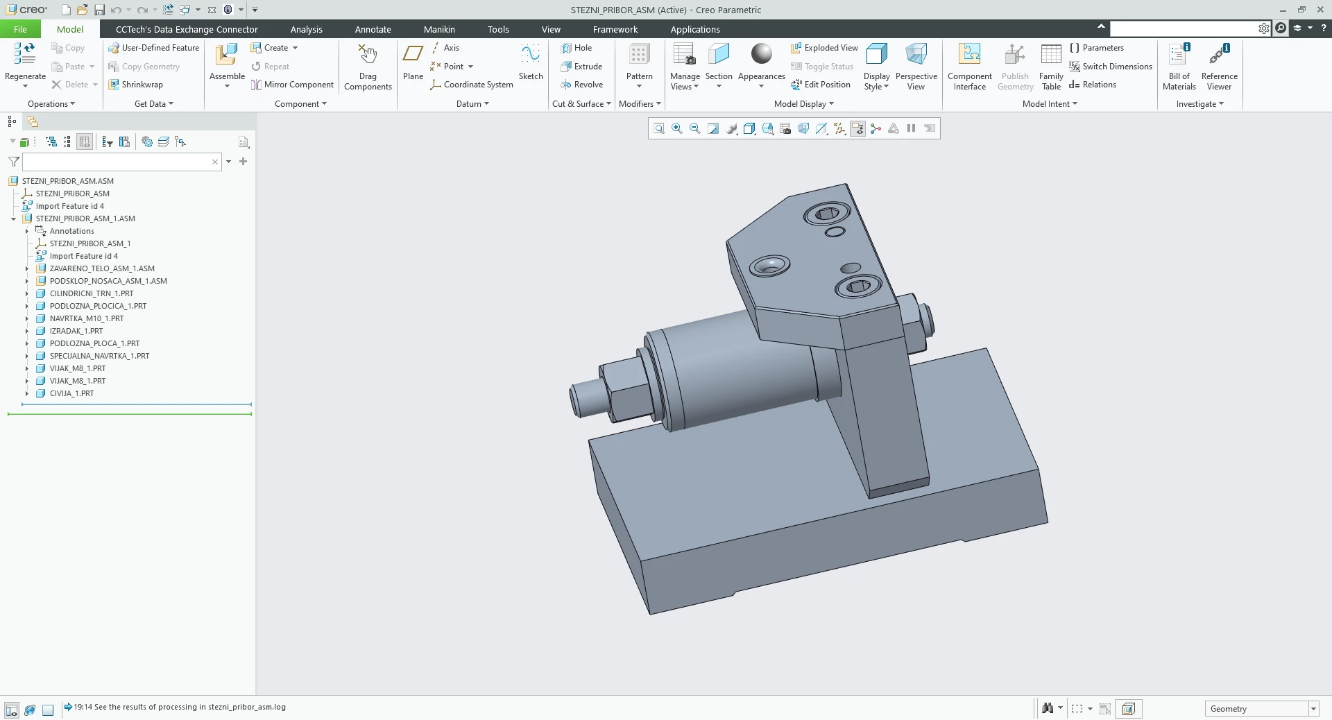

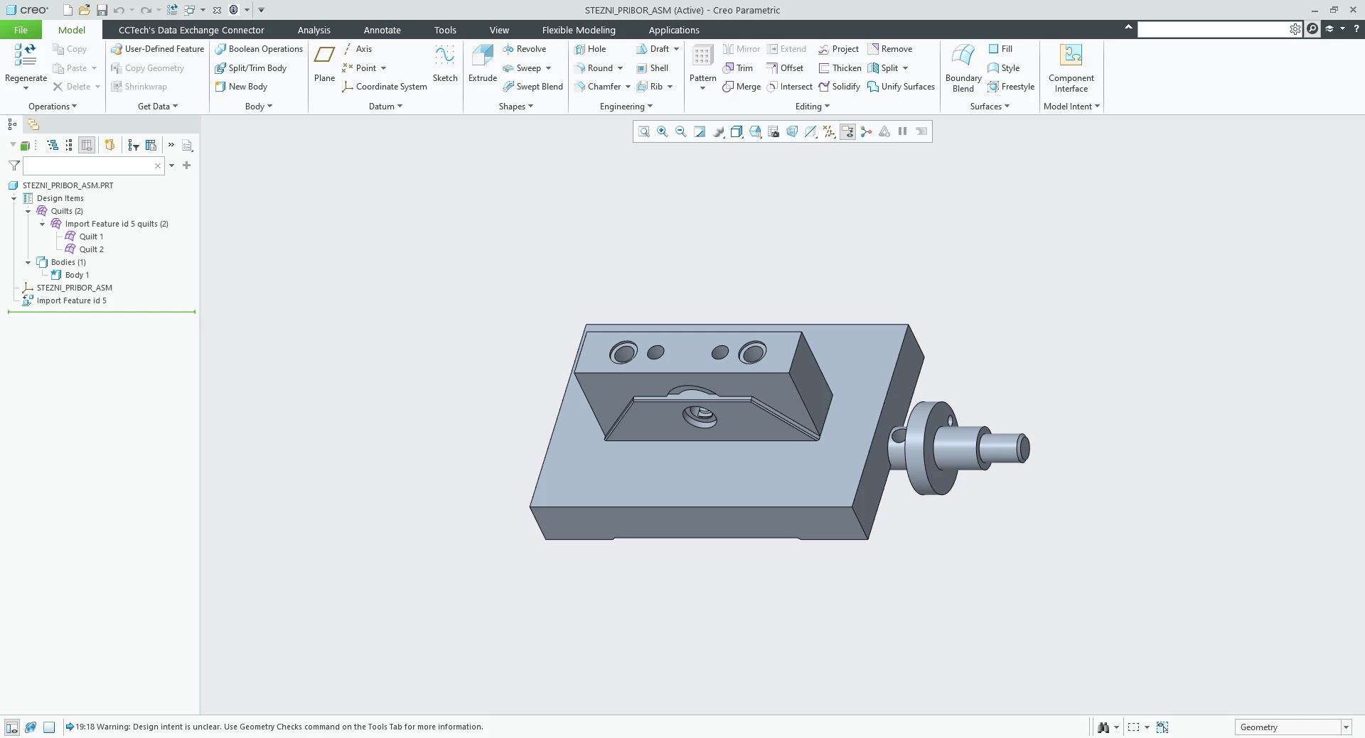

When I import an assembly STEP (stezni_pribor_asm.stp) into Creo’s Part mode (File > Open > .stp, Type = Part, Import type = Geometry), the resulting part has wrong geometry: some solids in the STEP file come in as open quilts, some components are missing, and the rest overlap.
Creo reports: Warning: Importing assembly in part mode. Geometry may be wrong.
  • WARNING: One-sided edge found in IMPORT FEATURE.
  • WARNING: Unattached IMPORT FEATURE was detected.
  • WARNING: Feature creation resulted in overlapping part geometry.
  • Warning: Design intent is unclear. Use Geometry Checks command on the Tools Tab for more information.
The same file imported with Type = Assembly comes in perfectly - every solid component comes as a solid, correctly placed. I have attached the step file and screenshots of both imports - the same STEP file imported as a Part, and imported as an Assembly for reference.

STEP file imported as an Assembly:
STEP file imported as a Part:

To bring a step assy in to creo as a single part, you need to add the hidden config.pro option intf3d_in_as_part yes
See the link for extended discussion.

Looks like all the pieces that are correctly located in the assembly are conglomerated together when you attempt to read them is as a part. Instead of being positioned where they are supposed to be with respect to the assembly they are grouped around their default coordinate systems. I seem to remember seeing this behavior with models we received from a customer.
