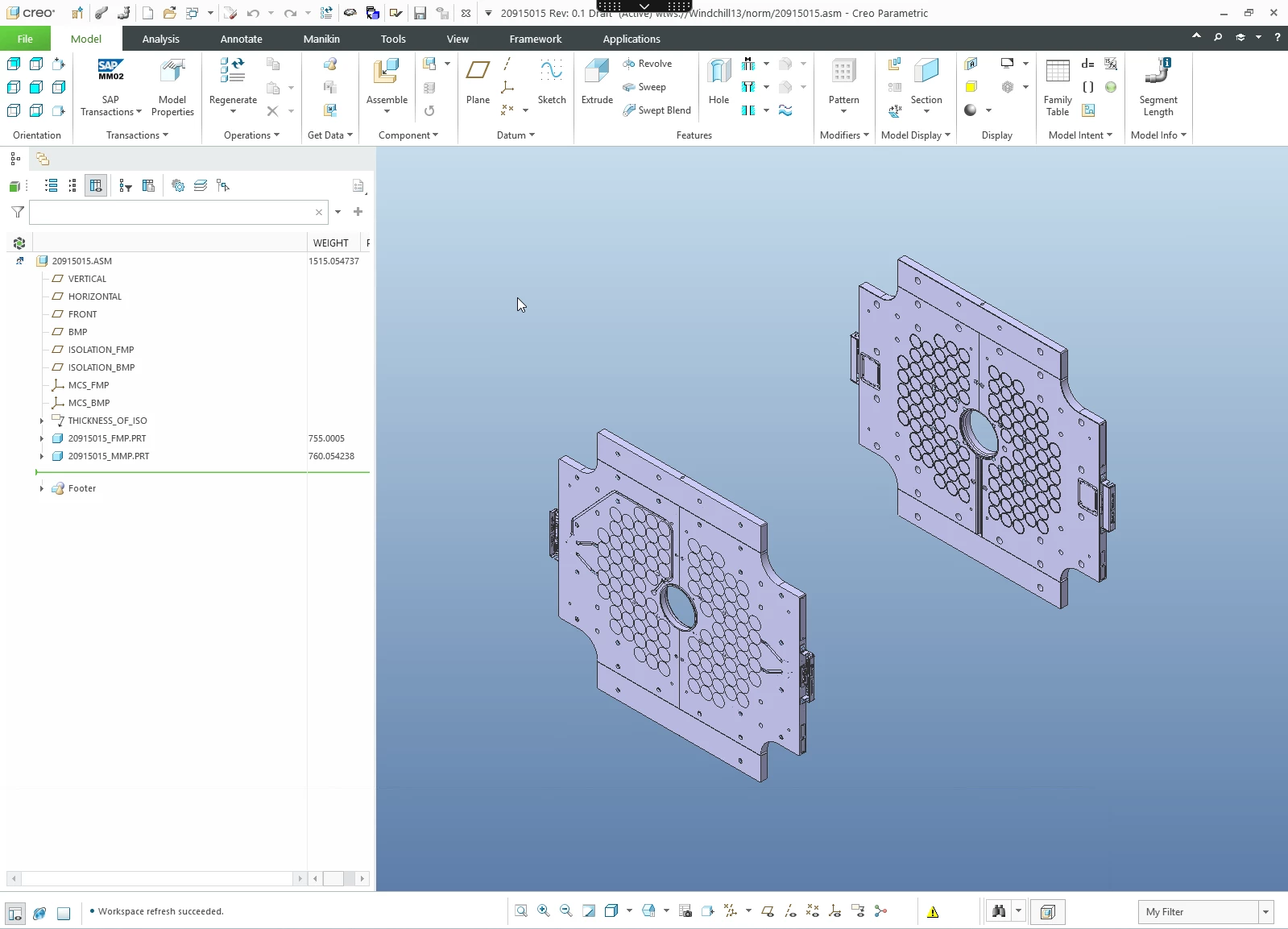

In the Creo assembly I have a weight which is not ok when I calculate model separately.
Do you know why happened?

Model tree weights sometimes don’t update immediately, espcially if the weight parameter is generated as a relation, Run mass properties under the anaylsis tab and see if the weights are showing correctly there. If so, regenerate the model and the model tree should update.
I not, I don’t know how to trouble shoot this without the model. Can you provide the model as a zip file as an attachment?

In addition to information shared by Stephen, try suppressing on part and check if assembly weight is updating or not. Also, check the weight of each part, update the parts, recompute the mass properties and verify the relations.

Depending on your settings, you may need to update your mass properties by selecting File > Prepare > Mass Properties/Change > Calculate > OK

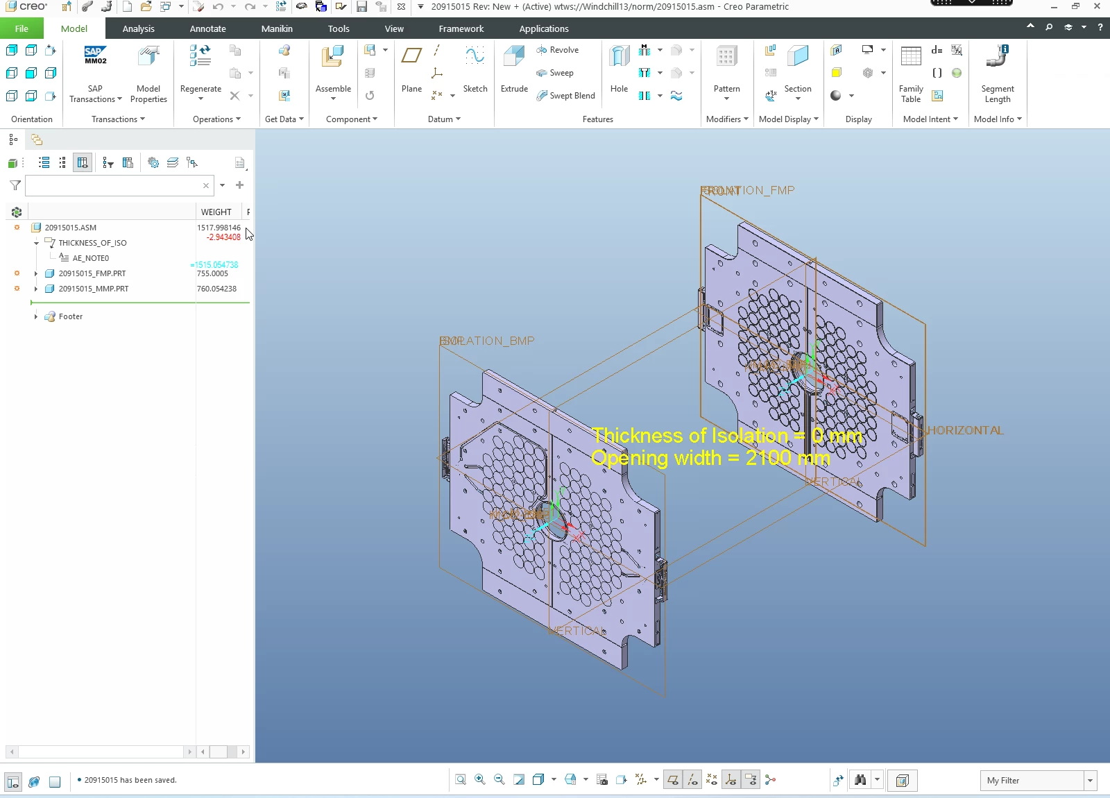

Dear all, thank you for your support. After check-in to Windchill weight is ok now:

Just to be clear, a check in to windchill would not “fix” a model problem. At some point likely a regenerate or some other action actually corrected the problem. From the screenshot, the parameter “weight “ likely needed to be recalculated based on a relation.  But there are other areas where  the weight would not calculate  correctly.
