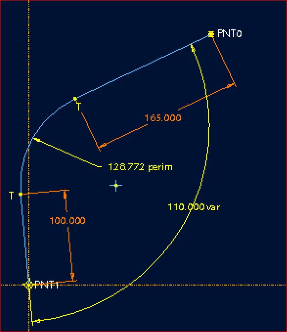

I have a part in an assy. The part is a hose connecting 2 points in the assy, on fixed and one on a another part that can move within certain limits. I want to make sure that the hose will adapt its bending curve to achieve this but you have to remember that the hose must have a fixed length and only the bend angle and the radius an vary.
If I could lock the bend arc length to a set value it would be easy.
Fixing the hose to its known start and end points, locking the value the length of the straight (not bendable) ends I only need to lock the arc length.
I can measure the arc length but have not been able to find a way to lock this value.
Help!

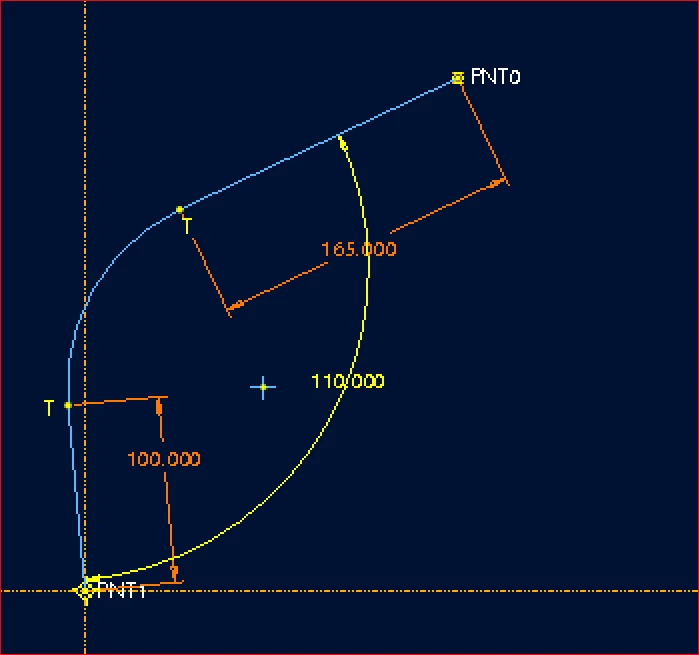

    Hope this makes it clearer:
    upload_-aW1hZ2UwMDEucG5n-1090512392718706214..pngupload_-aW1hZ2UwMDIucG5n-3383428589163942700..png
    This screendump shows 2 rigid rods, length 100 and 165 respectively, connected by a flexibel hose.
    The rigid rods are fixed to PNT1 and PNT0 respectively.
    I want to assign a fixed value the the length of the flexible part in order to see how the curve changes when I move PNT0 in relation to PNT1.
    I can calculate the arc length using the perimeter type dimension but I have not found a way to assign a value in a relation.

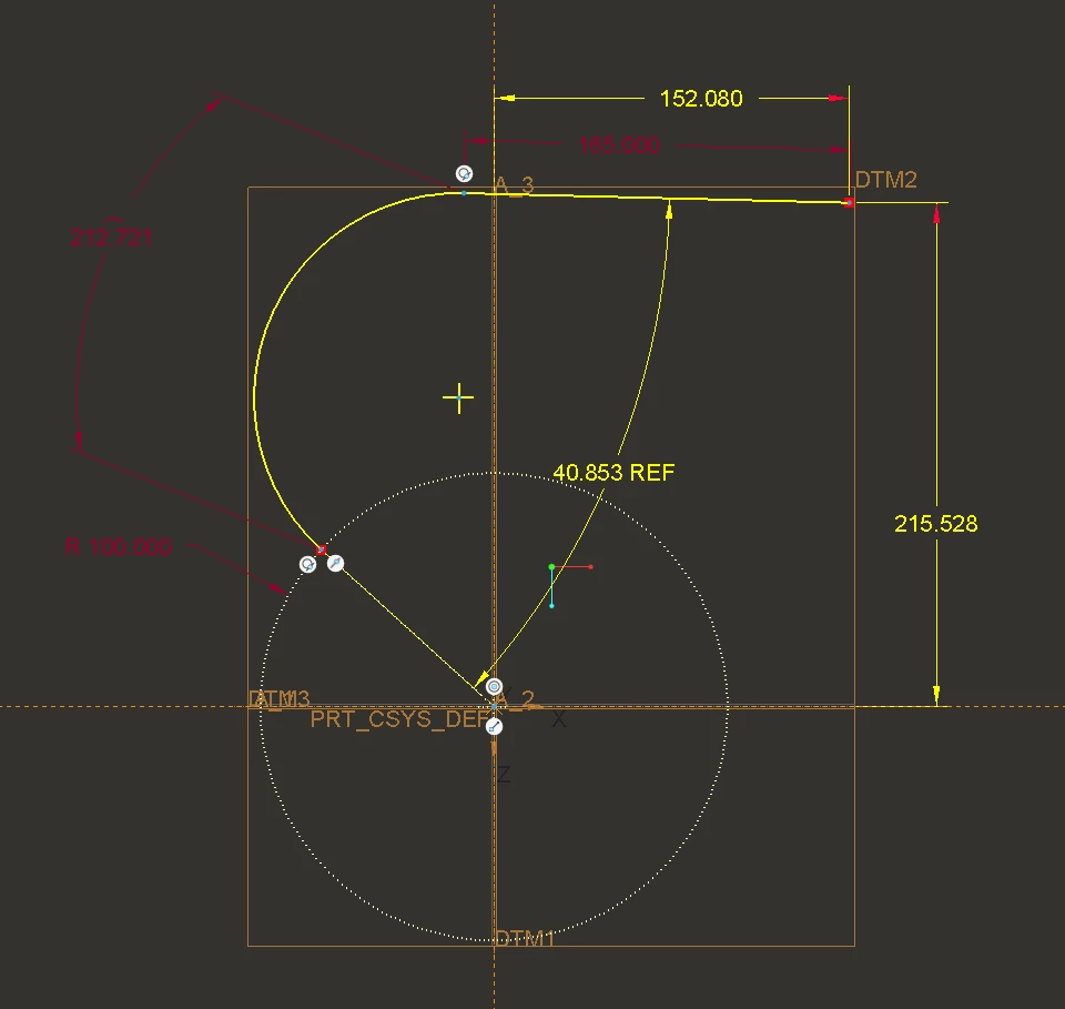

    If I understand the problem statement correctly, then this should provide a sketch that will define the range of geometry within a limited range.

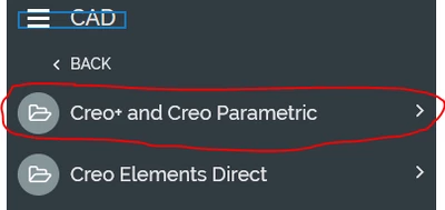

    If the question is for Creo or Wildfire or Proengineer, then this forum is the wrong one.
    PTC has two CAD systems:    Creo+ and Creo Parametric    and     Creo Elements Direct.
    Which makes it confusing.
    More, for Creo Elements Direct:
    - The 3D software name is Modeling, and
    - The 2D software name is Drafting.
    For Creo+ and Creo Parametric, use only this tab:

    You want to control your sketch entities with a perimeter dimension:
    https://youtu.be/Zig2lhj24WI?t=1097

    If you want to lock the length of the "flexible hose" then apply the arc length dimension in the sketch as shown here and lock it.
    To add the arc-length dimension, click one end of the arc, then click the other end, then click on the middle of the arc, then finally middle click outside of the arc and you'll get a dimension. Note the "eyebrow" symbol above the arc length dimension below.

    Jun 1, 2024 8:50 AM UTC
    Many thanks to all of you!
    The solution was to (in sketcher mode) convert the angle dimension to perimeter and add a relation locking this perimeter dim to a fixed value.
    I had already tried this in part mode but there it was not possible to use the perimeter drawing in a relation – never mind why.
    I might add that I am working in 1 plane only, the reason being that the hydraulik hose manufacturer recommends avoiding any twist of the hose.
    Thanks again.
    My issue is solved!
