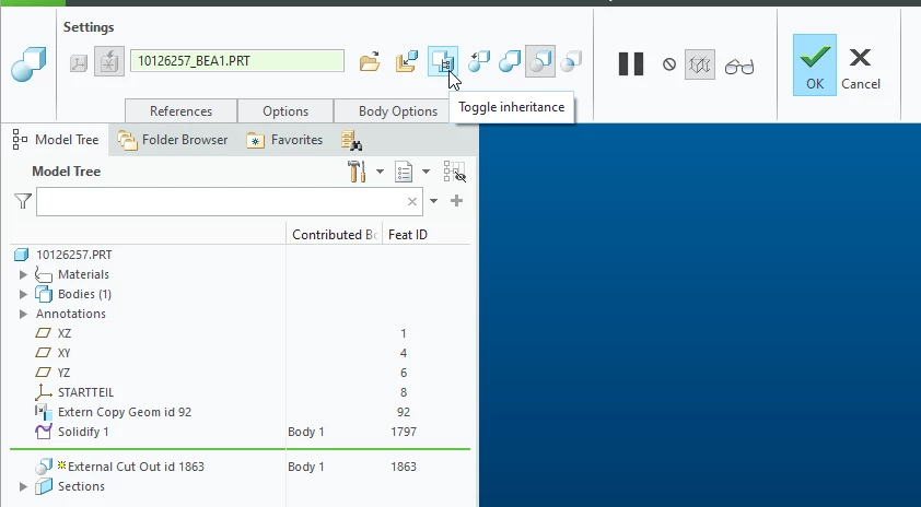

For inheritance features: Changes in the reference part are associatively propagated to the dependent Inheritance feature when both reference and target parts are in the same session. You can control whether Inheritance features are dependent on the reference part.
In your reference to the verb 'toggle" are you using it to describe this action?
Click to toggle between Merge mode (default) and Inheritance mode for the feature.
If so you are changing the feature from a merge to an inheritance feature. It is not clear what your expectations would be for enhancements to this?

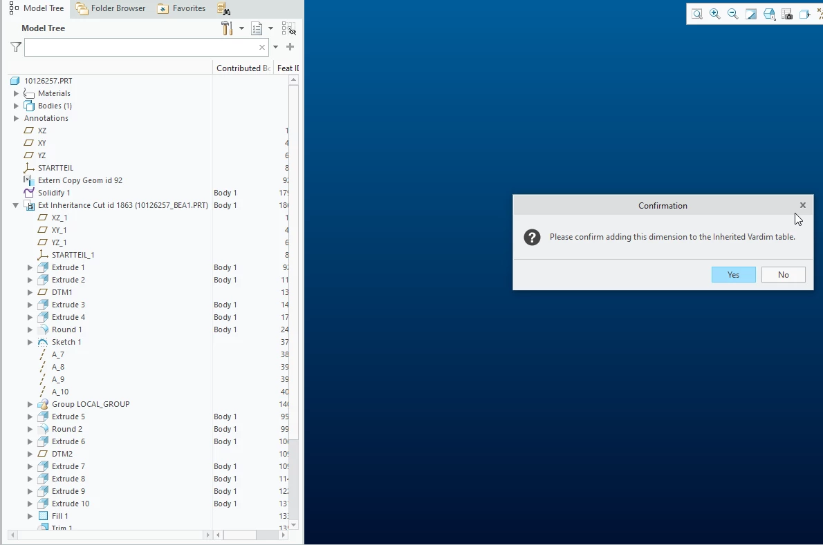

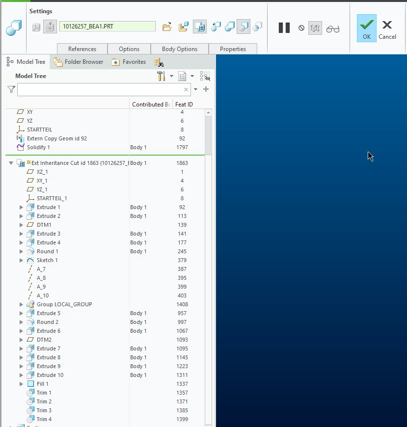

The option ''Toggle inheritance'' is available in the function ''Merge/inheritance'' (see image Toggle_Inheritance) and allows to import the functions of the base model in the model tree of the part (see image Model_Tree).
Unfortunately, if we modify the functions in the part, the base model is not updated (see image Modifications).The associativity is unidirectional and this creates differences between the base models and the parts.

Inheritance brings in all of the features of the inherited model.  This allows you to make changes to the inheritance, but not the original model, in the part.  Any changes to the original model will update in the inheritance.  It is not a "two way street."
I use this function regularly for molded families of parts.  The base model includes all of the possible features (mold inserts).  Each model variation inherits the base model and individual features are either suppressed or unsuppressed in the inheritance.
