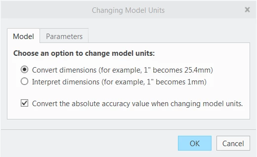

Sometimes I need to get a drawing in inches and want to make a cad model of it. I normally use mm, so is there a way of typing in the dimensions in inches and have Creo automatically convert to the default (mm), for example with a specific tag or something? It's time consuming to convert all units externally first.

The easiest method to automatically convert  is to change the model units. You can model the part using the drawing with units of inches directly from the drawing. You would then convert the model units to mm. If the convert dimensions option is used then you will get the desired results. If accuracy is important to you then pay attention to the absolute accuracy setting and what it means in your environment.

You could also model to nominal values (1 inch - 1 mm) then scale model by 25.4 or 1/25.4.
