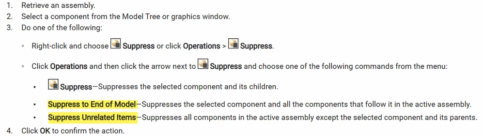

Dec 15, 2022 1:15 PM UTC
Have you tried using the suppress options in assembly mode? They may offer a quick solution if you just need to suppress items you are not interested in working with.
Dec 15, 2022 1:22 PM UTC
I have tried this, but I am looking for something more automatic that occurs as it is regenerating where creo ignores any errors that arise in the failure diagnostic.
