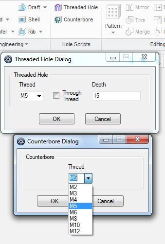

In my work I create a large amount of threaded holes in my designs and the hole placement UI can be a little tedious.
To solve this, yesterday I created two rough AutoIT scripts that simplify my hole workflow by selecting my most common parameters.
I need to modify the thread depth to a formula to allow for clearance, but at the moment they match the thread depth to the hole depth.
They can be called through mapkeys that I have placed on my ribbon.
They work on Creo 3.0, with tweaking I am sure they will work in other releases.
I would just like to share these with anyone who may find them interesting or even put them out there to be tidied or improved upon.
I am far from being any kind of coder but I am happy to explain how they work and welcome your feedback.
Enjoy
Miles

I have AutoIT v 3.3.14.2 installed that will explain the #include being incorrect.
What are your thoughts on the execution of the script? A counterbore has gone from 9 or more clicks (depending on thread) to 4 (2 if you want the default of an M5 C'Bore)
It saves me so much time now and reduces errors from missed or forgotten clicks.
I hope they could be useful to others or even inspire others to streamline their own workflow. 🙂
I guess TOOLKIT could be utilised with greater affect but I do not know how it works.
Miles

Hi Andreas,
You are right, I did create 2 mapkeys using OS Script and placed them on the ribbon.
I copied the hole icon and modified it to give me a good visual icon.
The os script looks like this in the config.pro file:
mapkey 02auto @MAPKEY_NAMEAutoIT Script Threaded Hole;\
mapkey(continued) @MAPKEY_LABELThreaded Hole;\
mapkey(continued) @SYSTEM"C:\\PTC_ConfigFiles\\AutoIT_Scripts\\Thread\
mapkey(continued) ed_Hole.au3";
mapkey 03auto @MAPKEY_NAMEAutoIT Script Counterbore Hole;\
mapkey(continued) @MAPKEY_LABELCounterbore;\
mapkey(continued) @SYSTEM"C:\\PTC_ConfigFiles\\AutoIT_Scripts\\Counte\
mapkey(continued) rbore.au3";
Or like this in the mapkey UI
Miles
