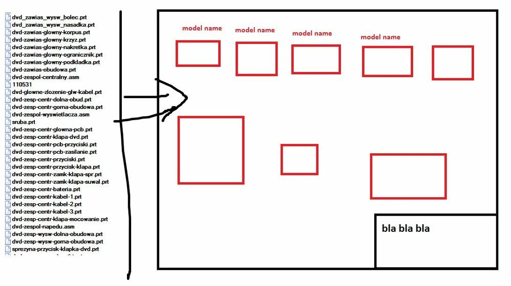

I would like to push Creo to create automaticaly drawing or at least in existing drawing, single view (with prefixed orientation from model) of every model from indicated folder. layout or pattern of such created views is secondary to me. Advantage would be to have appropriate model name and scale above of every view
Is something like that possible at all? thank you in advance
