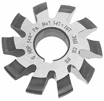

I was a machinist and made many gears.
Gears are made by creating a turned blank and using a specific hob gear cutter to mill and index each gullet. The end result are the teeth left over after milling.
Many gear programs work the opposite way by adding a tooth instead of a gullet cut. If you want true gear geometry, consider a workflow where you cut the gullet with the exact profile of the specific hob gear mill that will machine it. It’s in the machinery handbook.
Modeling teeth is problematic in my experience.

8-Gravel
Thank you for your comment. I agree with the points you mentioned, Michael, and that’s exactly how we’re doing it — we’re modeling the cut as if it were the machining tool. I believe the cutting profile we’re using doesn’t fully represent the actual profile. As I mentioned in the previous response, we’re going to review our template, both in terms of parameterization and the cutting profile applied.
