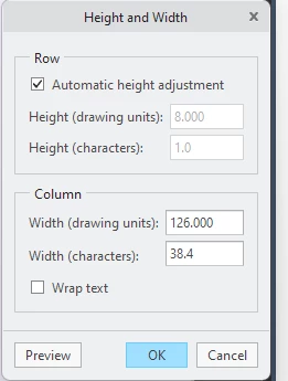

Hi all, first post!  My question is that the way we like our text within our tables to look is centered horizontally, meaning the box borer spacing above the text is the same as the spacing below the text.  When I select the 'Automatic height adjustment' box, the lower border is much closer to the text than the upper border.  Is there a way to change the "cell padding" around the text to center this?  I've searched for config parameters on this with no luck.

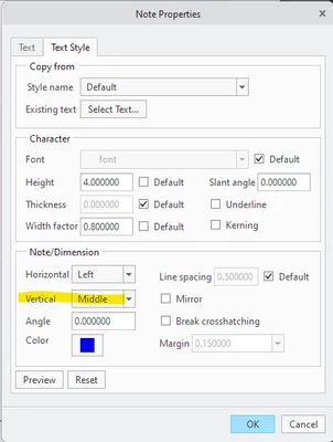

I am using Creo 7.0 and it stays centered for me. Can you attach an image of what you are seeing? Is there a return above the text?
There are 2 things to look at: height and width and note properties - text style

So the first is me setting the height of the table row as I would like it... same amount of space top and bottom.  6.76 "drawing units" is what I used.
The second is turning on the "automatic height adjustment" which (at 7.938) has way more space below the text than above.  Looks sloppy to me.
I don't want to use middle for the body (change description) because then I would have to use it for all my columns or they would not line up.

Try adjusting the line spacing factor to match the top offset.  Not sure exactly how it works but it will adjust the bottom offset with automatic height adjustment.  It appears that automatic height adjustment puts the line spacing under the last line.

Per article CS271661 Creo does not have the ability to adjust cell margins.

That article is a little misleading.  It is true that you can't easily adjust the padding after a table is created, but you can certainly adjust the padding while the table is being created by setting the default text height in the drawing where the table is being built first.  While more complicated, you can also adjust the padding after a table exist by scaling a drawing with the 'variant_drawing_items_sizes' config option set to 'yes'.  (I've used this trick a bunch to create different size title block for different sheet sizes without needing to manually rebuild the tables.)
By default, the cell height is double the default text height and the padding is half the default text height.  You can adjust the default text height to do some cool things.  (Intentionally set it really small when creating the table, etc.)
