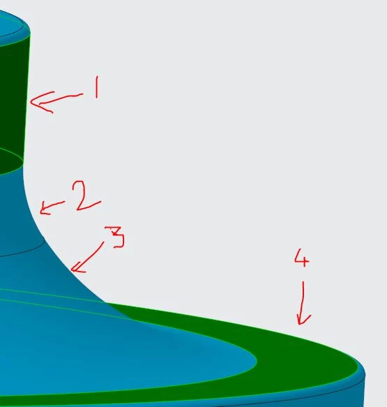

Hi All,
 I would like to automatically select all the surfaces (1,2,3,4) between two highlighted surfaces ( 1 & 4 , See attached image) in creo. The thing is I don't want to select all four surfaces individually. Is there any command or any way where I need to select only 1st and 4th surface and creo would select all surfaces in between automatically?
Your help would be highly appreciated.

Use the seed and bound selection method to implement your objective. The command sequence is not exactly what you describe but is the closest available.
See the PTC QRC for tips (page 12 in the English version).
