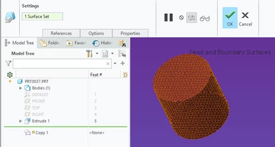

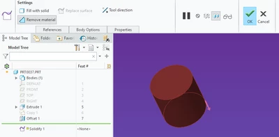

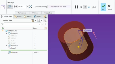

No automatic way that I have seen.  You can copy all surfaces (select a surface, hold shift and select surface again, hold ctrl and select any non-finished surfaces if needed, ctrl+c, ctrl+v) offset quilt, remove material with solidify.  If there are any unfinished surfaces you may need to extend the quilt to fully intersect the model.
