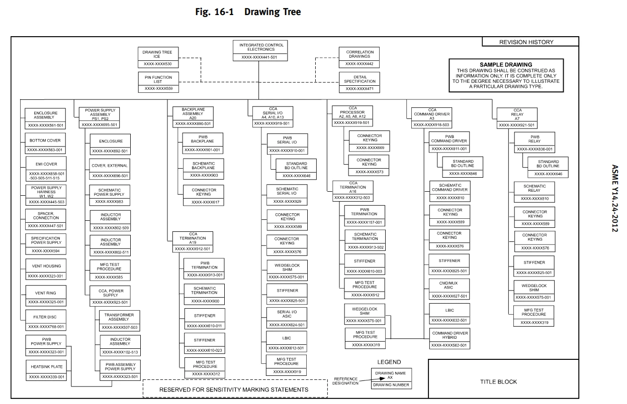

Is there a way for Creo to automatically generate a drawing tree? I'm not talking about the assembly drawing tree in Creo interface. In ASME Y.14.24 Types and Applications of Engineering Drawings, section 16, there's a Drawing Tree section. I'm talking about this. I attached the screenshot of it here. I have to make this drawing tree, and we have a lot of parts. It just doesn't make much sense to do it manually if Creo already has a feature for this. Thank you so much!

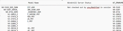

If you have Windchill, you can get an indented assembly structure list. Drawings are not 'connected' only the assemblies and parts.
