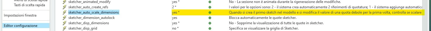

Hi, I'm a new users of Creo 11.0.2.0
I have set in my configuration (view the attachments) the option "Automatically Scaling a Sketch" but it's not work. Are there some other configuration to able or disable?
Thank you

please explain what you expect and what Creo does. I need to know the difference between reality and expectations.
7-Bedrock
Nov 29, 2024 8:53 AM UTC
My expectation is "https://support.ptc.com/help/creo/creo_pma/r11.0/usascii/index.html#page/part_modeling/sketcher/About_Auto_Scale.html"
but if I sketch a rettangle and I change one dimension, the other dimension does not scale like in the video (see the attachment).
I try to sketch other shape but the result is the same.

Works as expected in Creo+ (12.1).  This only applies to the first weak dimension, in the first sketch, that is changed.  It also does not apply to an added dimension.
