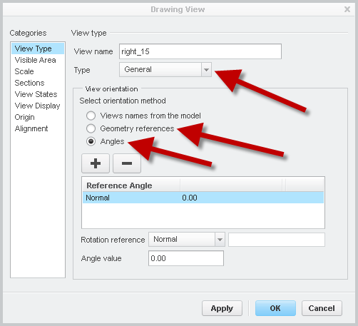

Hi friends if anybody know how to rotate auxiliary view in creo means please help me out
9 replies
StephenW
Aug 8, 2016 12:59 PM UTC
Right click on the view, select properties. Change AUXILLARY in the type drop down to GENERAL, then APPLY. You will get additional options then. Use GEOMETRY REFERENCES or ANGLES to rotate the view as desired.

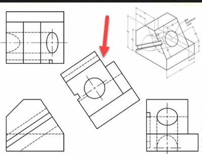

Is there any standard angle for auxiliary view? If it's there any standard values please reply.
StephenW
Aug 23, 2018 11:55 AM UTC
An Auxillary view is an orthographic projection that is taken from ANY angle that is required to accurately represent the geometry.
In the image below, the auxillary view is at the angle of the surface that the hole is one so the hole is shown "true".
