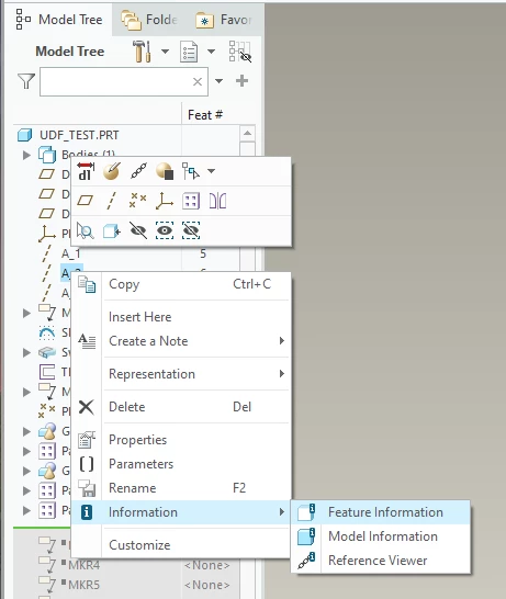

Good afternoon, the part axes and planes are hidden by default when added to an assembly, and I can't find a way to unhide them.  Is there a setting in the configuration that could be the cause?  I am using CREO Parametric 8.0.5.0.   Thank you!

Use feature info to query if a given feature is included in any model layers (part/assembly). If they are on a layer check the layer display to see if it is hidden. If hidden, show the layer. The features may be added to layers automatically if layer rules are in effect when creating them.
Aug 23, 2023 8:26 PM UTC
Thank you for your reply, @tbraxton .  As far as I can tell, it is not part of a hidden layer.
tbraxton
Aug 23, 2023 9:07 PM UTC
When you use this query none of the features in question are in a layer? You may have to scroll down in the info window to see the layer information. Can you post the models or at least the layer tree of the active model with the problem and the results of the feature information query executed as shown below?
