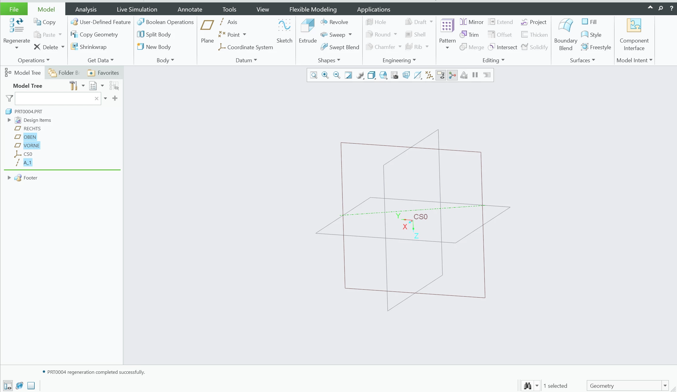

I am having an issue where when I create an axis, it does not appear to be in the correct position and is in fact in a wild poisition. For example, I create a new sketch, select two of the coordinate planes (Front and Right for example) and then click "Axis". You would expect this axis to show up as a line intersecting the intersection points of the two planes. However, what shows up has no visible relation to the two selected planes. See "creo pic 4".

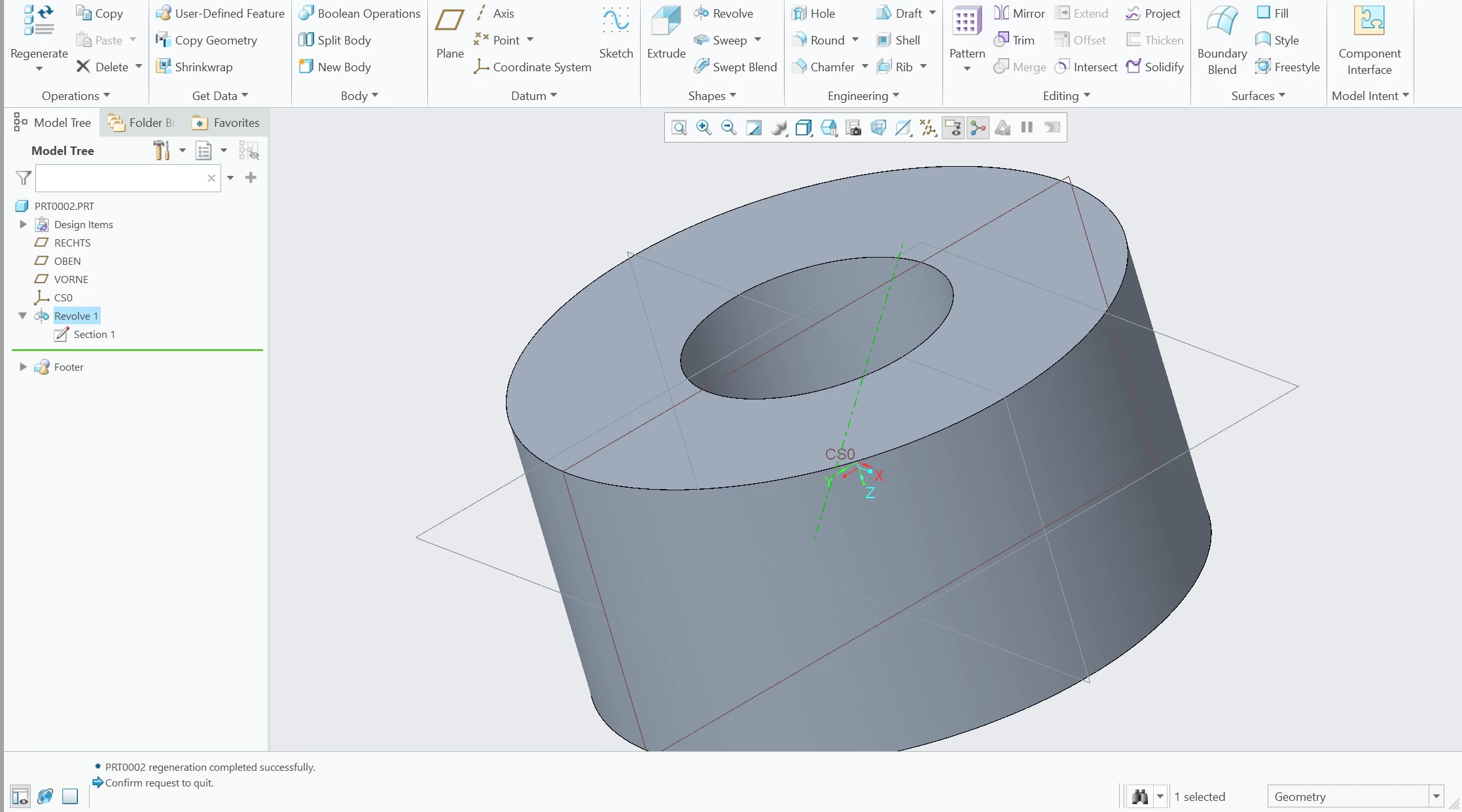

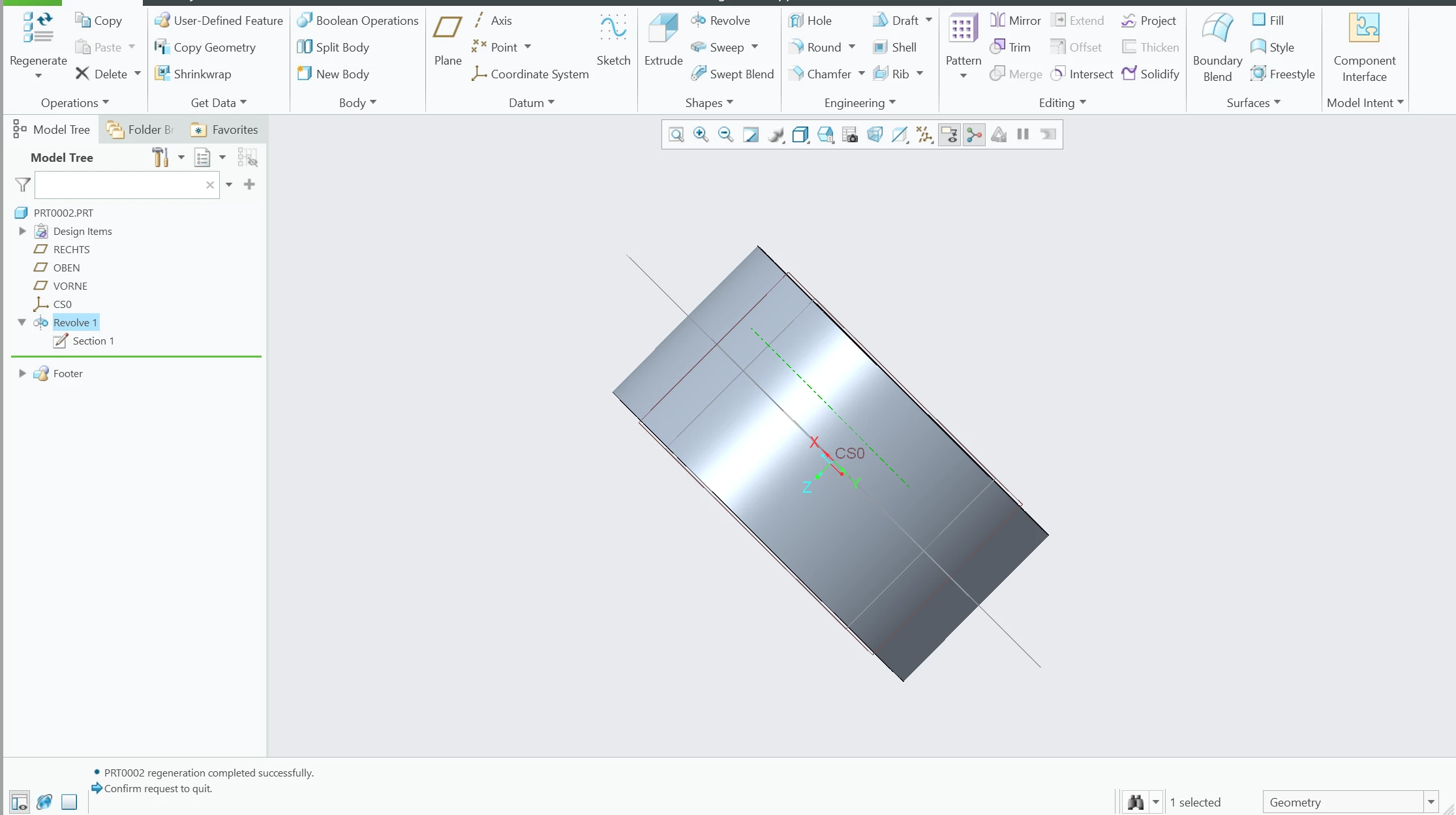

Another example is when I use "revolve". I create a sketch with an axis and a shape (square in the picture) and the revolve works perfectly, but the axis of revolution is totally wrong and shifts as I pan/zoom around creo. See picture 1 and 2.

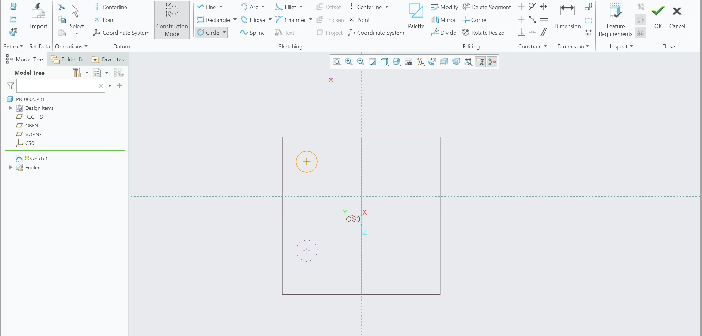

The last example is when using construction lines in a sketch. The construction shapes appear in totally different places from where I place them. See picture 3. In this example, I placed the construction circle in the exact same location as the "real" circle, but it shows up in a totally random place. I belive this has something to do with the blue-dotted lines on the sketch, which for me are not alligned with the principle planes (as they should be based on others experience).

You might try attaching a zip file with a part in it. I see it's an educational version, so many of us won't be able to open it but maybe someone will.
I am guessing this is a graphics issue, maybe related to the virtual machine also.
Try adding graphics win32_gdi to your config.pro and restart creo. If it seems to correct the issue, it is related to graphics card issues. I am not sure how that works with respect to virtual machines.

Jun 21, 2022 4:41 PM UTC
Thank you so much, this was the solution. Is there any issue with just using it in this way with win32_gdi? Thanks again, I've been trying to figure it out for hours.

Jun 21, 2022 4:46 PM UTC
That tells you it's a graphics card related issue. The option turns off any help your graphics card will give you.  Creo performance will suffer.
You can try updating your graphics card drivers. I  don't have a clue how that  works with respect to virtual machines.
