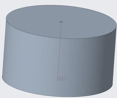

Hello everyone,
We just upgraded to CREO 11 from CREO 7.   Axis are showing up as solid lines in models in 11 but show as center line 7.  I've been looking for a config setting or something to fix it with no luck.  Gets to be a mess with large parts.  They display better in drawings, you can zoom in and see it's a center line at least.  They show up correctly when printed.
Any suggestions?

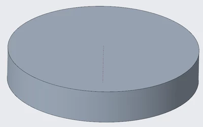

Is this an imported model (STP, IGES or similar)?  I have Creo 11 and axis show as centerline.
3-Newcomer
Apr 21, 2025 6:51 PM UTC
Nope it's CREO parts.  My co-workers CREO 11 displays correctly.  I'm stumped!

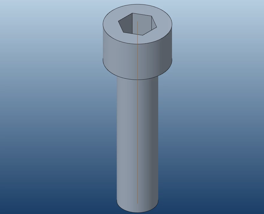

Apr 21, 2025 7:11 PM UTC
Is it possible that there are multiple axis in this location that are really close together but not perfectly aligned?  I can achieve what looks like a solid line using two features that are offset by 0.001mm
