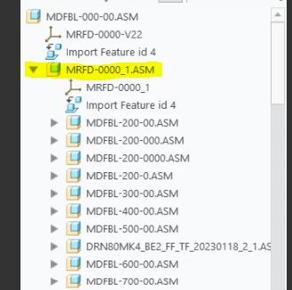

@BL_10341087 wrote:
i have the table but parts from this assembly doesnt show up
unfortunately, the description of the problem is insufficient. Please publish following:
  • picture of assembly model tree
  • picture of repeat region showing repeat region parameters
Note: When reporting a problem, it's always best to upload Creo data.

Dale_Rosema
Jan 30, 2023 5:25 PM UTC
When you mention "parts from the assembly" are you referring to subassemblies to the assembly, or subcomponents to the subassemblies? (i.e. children or grandchildren?)
Jan 30, 2023 5:44 PM UTC
subassemblies
Dale_Rosema
Jan 30, 2023 6:13 PM UTC
From what I can see, you only have one part in the top level assembly:
