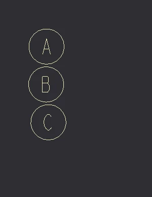

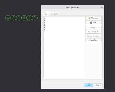

When I'm writing balloon note with a multi-lines it makes them as a separate balloons aligned Horizontally.
Is there any method to make them aligned Vertically like this in one note like the previous one
Aug 23, 2023 8:20 AM UTC
use Vertical option. In my test values were displayed from bottom to top, so you'll probably have to enter the values in reverse order.

Can I have both as a table distribution like this
(In a single note)
Aug 23, 2023 9:05 AM UTC
@ELDAFRAWY wrote:
Hello Martin,
It works great.
(In a single note)
I do not think that both direction "table" can be created using Balloon Note command. I am sorry I cannot offer any other solution.
