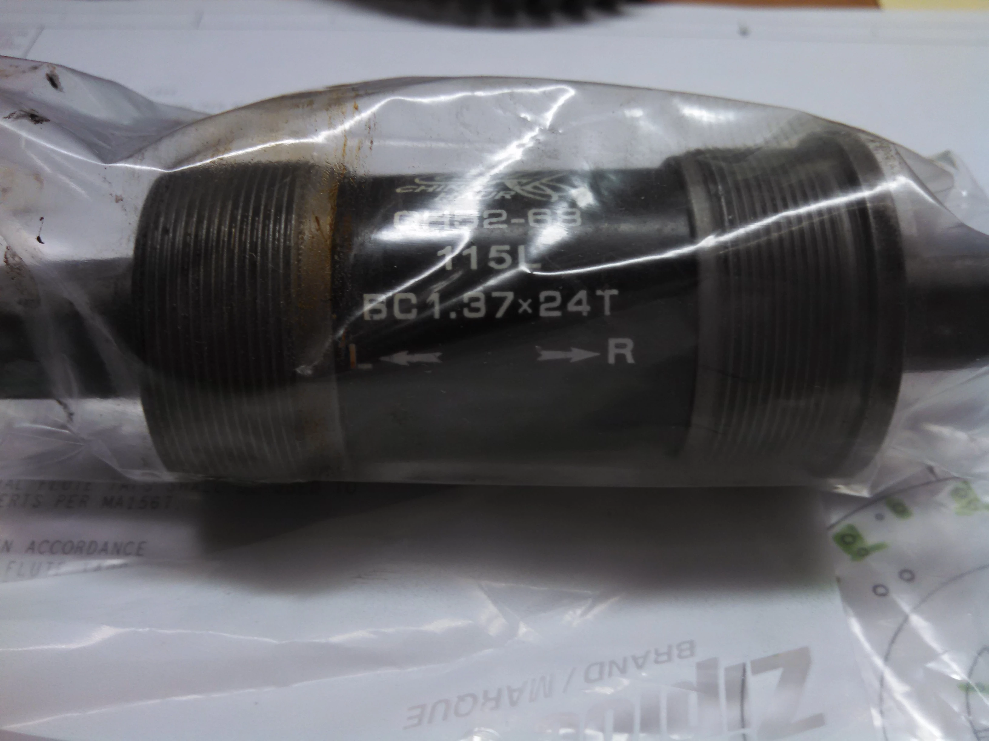

BC 1.37 x 24T (Bicycle pedal hub threads/right & left hand)
Howdy,
Anyone know how to model these threads (female/hole) in CREO 2.0?
Please and Thanks.

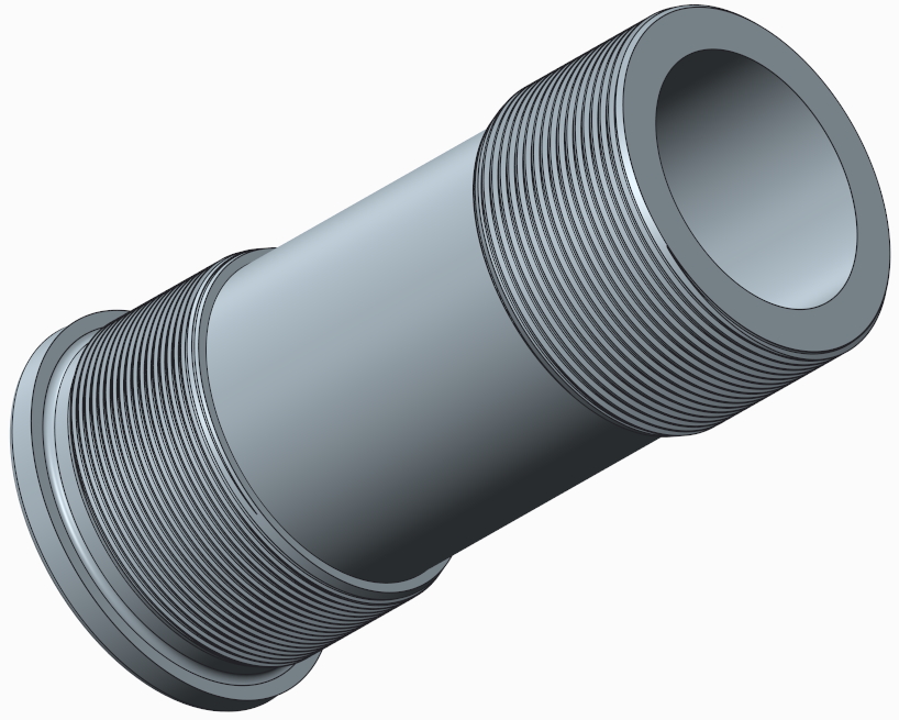

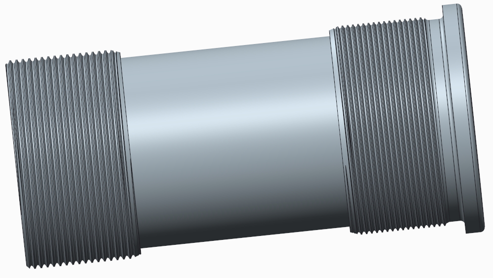

November 19, 2014
Looks like the thread is actually a British Standard Cycle Thread (BSC)....slightly different than UTS, UN, etc...but apparently ISO compatible.
http://mdmetric.com/tech/thddat17.htm
Anyway, for migrane fun, I modeled the threads using VSS....my favorite since helical sweeps are sooooo ProE v1...and no fun . See attached. Bottom bracket (or whatever it's called) dimensions are a guess, but the thread should be correct.
