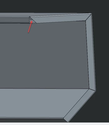

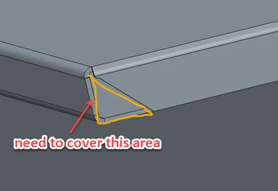

I have created a closed profile with sheet metal, but on the last two bends the corner is not closed and there is a chamfer there as shown in the following figures and attached file, how can I have a complete perpendicular edge there?

Remove the bend from the end of the chain to remove the chamfer.  You will then need to add your desired relief and possibly extend the wall.

Thank you for your reply it worked!
