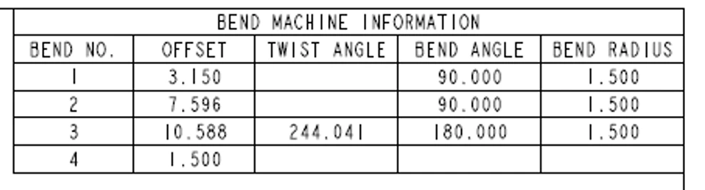

We have created a bend machine table and would like to use it on the drawing. However we would like to adjust the decimals from 3 down to 2. Any suggestions on how this can be done?

In the table, after each parameter, add [.2].
Just a warning, this truncates the value instead of rounding the value.
We use it on for weight on drawings. In this case, it's zero decimal places.
&PRO_MP_MASS[.0]
