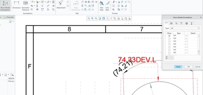

I am defining MBD states and views for one of my client. here is a situation where we have assemblies with 2 levels of components. can you describe be best practice to create dimensions. whether I have to create dimension for each component at the assembly level or create states and dimensions at part level then use the same in assembly level.

Create dimension at part level and then Assign the dimension in assembly level.

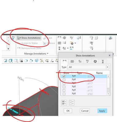

August 10, 2020
Please tell me the procedure the bring the MBD states from part and show them in assembly. not aware of the option.

Please treat the 3d model as a master container of all data where the drawing is a supplementary piece of data that take everything from the model.
It is the easiest when you create the 3d model, show all needed dimensions in selected planes, and in drawing you only show up what you need in a view.
This is a one-way process: model -> drawing - so please don't create dimension in drawing, with an intention, to show it in the 3d model environment. Because it won't work. It is how it is
Set up your creo correctly- folders location, templates /3 basic templates - prt, asm, drw, few additional parameters that are in the model, and are supposed to be shown in the drawing - in an ex. tolerance class, finish/, drawing standards first - otherwise you will be struggling like many before you had.
