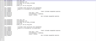

I recommend looking into ModelCHECK. You could add your parameters and relations with a start config pretty easily. The advantage is that you can run ModelCHECK at the assembly level to affect all children. In general, ModelCHECK is old, outdated, and tough to set up, but once you have it working, it works very well for things like this. Here's an example of a start config which is used to add relations and parameters to parts and assemblies.
